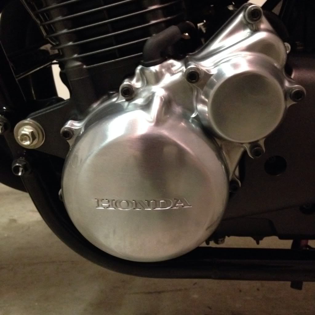

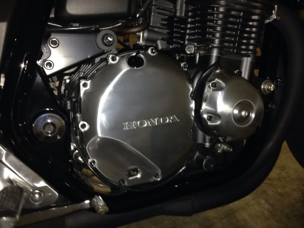

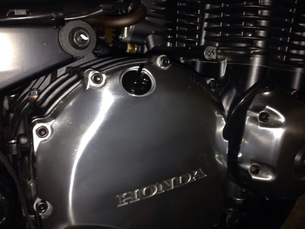

So I was at Austin Bolt Co. yesterday and picked up 28 black allen bolts for my left and right crank case covers.
I love the contrast of the black. and it will be so easy to remove these now!!!
I recommend doing this.
oh yea , pics!!

Well I LIKE it! Thumbs Up
thanks! i think it makes the bike look at bit more custom too. (not that i am having issues with that haha)
Looks great! and that's a great price. I think we charged more than that for a kit 40 years ago.

The standard bolt sizes for the CB are
25 - 6x28 mm
3 - 6x60 mm
The shop only had increments of 5 mm so I ended up with 25 6x25 and 3 6x55 (they were out of 60mm)
the bolts work perfect, still lots of thread to catch the crank case. I am not even concerned at all. If anyone wants a set, I can buy them for you. Let's say $15 shipped (gotta account for gas and packaging) but that is still a very good price. Let me know. The shop is only open m-f until 5pm CST (crappy hours)
sorry, not touching those bolts on my crankcase, no problem, no leak, not touching, keeping factory seal!
fairnuf, I have removed it twice and had no issues. I use Honda Bond to re seal the cover. I would have never done this but I had to replace the left crank case cover due to my bike falling.
The usual black oxide and phosphate coatings on fasteners are not very corrosion resistant. A epoxy type would be good but I don't know if that's available. Do you know what finish is on them? You might get some rust after a while.
i believe that they are armor coated. So says the shop. And if they do rust eventually, they were $7.50

My feelings as well. I have replaced bolts on multiple bikes over the years and usually found it wasn't worth the trouble. They look good and are a fun change at first, but often they eventually rust. If you get chrome or stainless, many times you need to tap your cases because they are slightly oversized, otherwise you run the risk of stripping the case threads-if not on the way in then on the way out later (actually I would normally run a die over the bolts as opposed to tapping the cases). There is also a risk of having them seize in the case because of hardness differences in the materials and wrong torque specs and then you have bigger problems. Then there is the risk of leaks. I have had ALL of these things happen at one time or another.
At this point I never change case bolts unless I need too...
