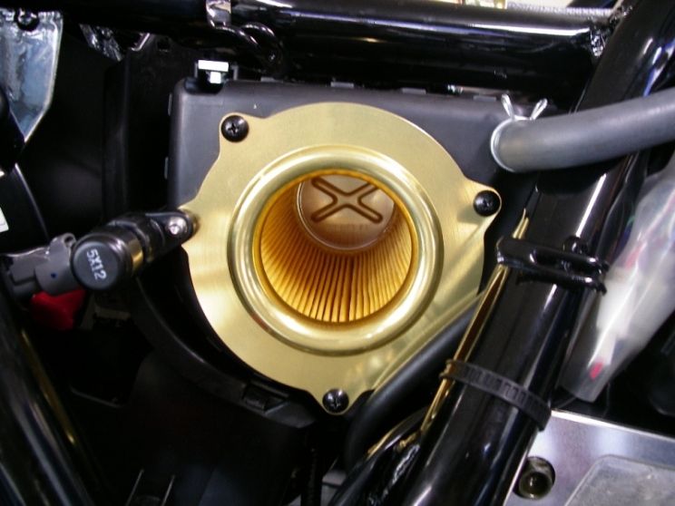

The first one, an air intake funnel, looks like a big intake port that fits into a hole in the side of the air cleaner box. It also seems like you are looking at a filter from the inside.
Apparently it needs a corresponding high flow silencer to work. Staintune anyone?

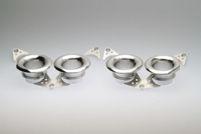

The second is a set of 4 air funnels that apparently go between the "intake manifold" ?? and the throttle bodies. These are 10mm wider than stock and are the same diameter as the throttle bodies.
So would it be something like this: 1)air intake funnel, 2)stock or K&N filter, 3) the 4 air funnels into the throttle bodies, then out via TSR headers and a hi-flow slip-on like the Staintune? I'm surely no expert and have never even seen my air filter.
Will these accessories, combined with an aftermarket full exhaust, turn the mild mannered CB into a beast?
