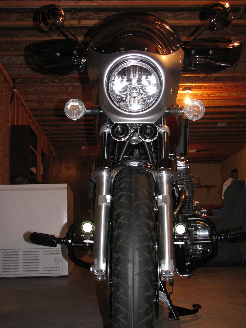

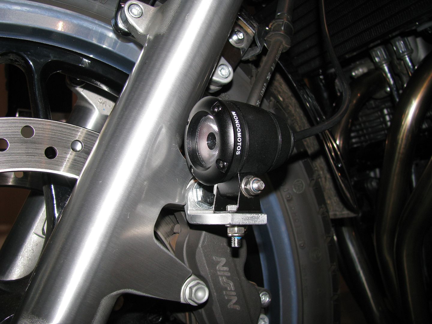

Over on ADVrider on the vender forum, there are many LED's being sold. I bought a pair of 10 watt LED's for about $109 shipped to my door. They are Mondomotos MM10 Bullets. I made a mounting bracket out of some aluminum stock I had laying around. They are very solid little buggers.
I like them down low, it gives a better triangle for oncoming traffic to see me.

relay, fuse holder, on/off switch, and two quick disconnects down by the lights. I go against the grain and wire them hot to the battery. I don't tap the hot lead into a key activated wire. I want to be able to use them with the key off.
I wanted to mount them to the fender bolt but decided the fender bolt was not substantial enough. The fender bolt on our CB is frigging tiny. So I made some brackets and put them on the caliper bolts. They are beefier. That is where I had my Motolights mounted for about 80000 miles. They only came loose once but that was on The Dalton Hy north of Fairbanks. That road is something else,,,,,
Those look great, nice install, Ole!

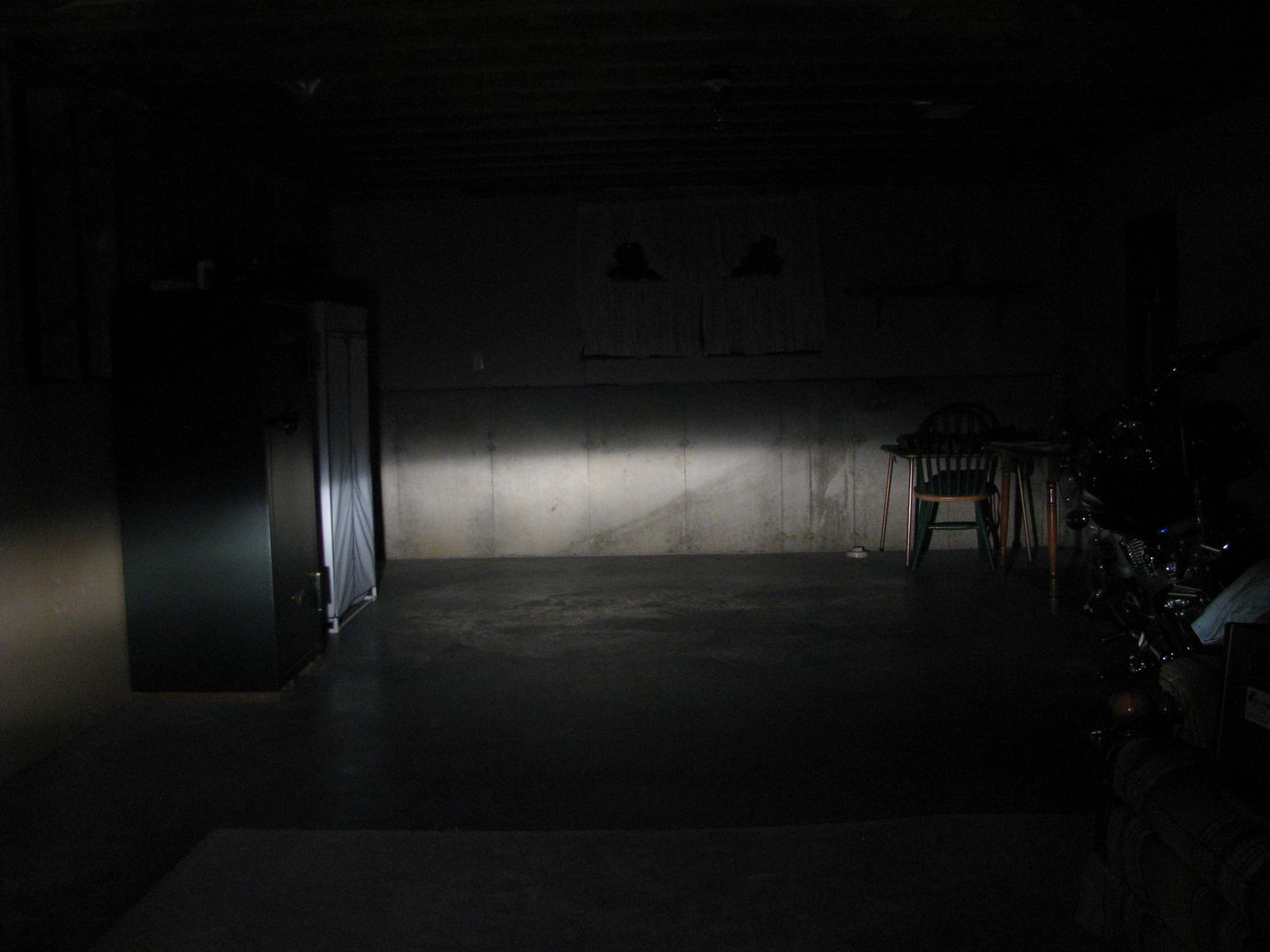

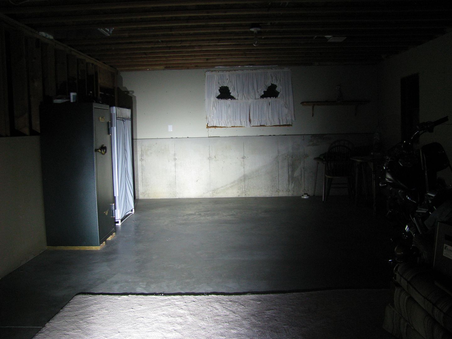

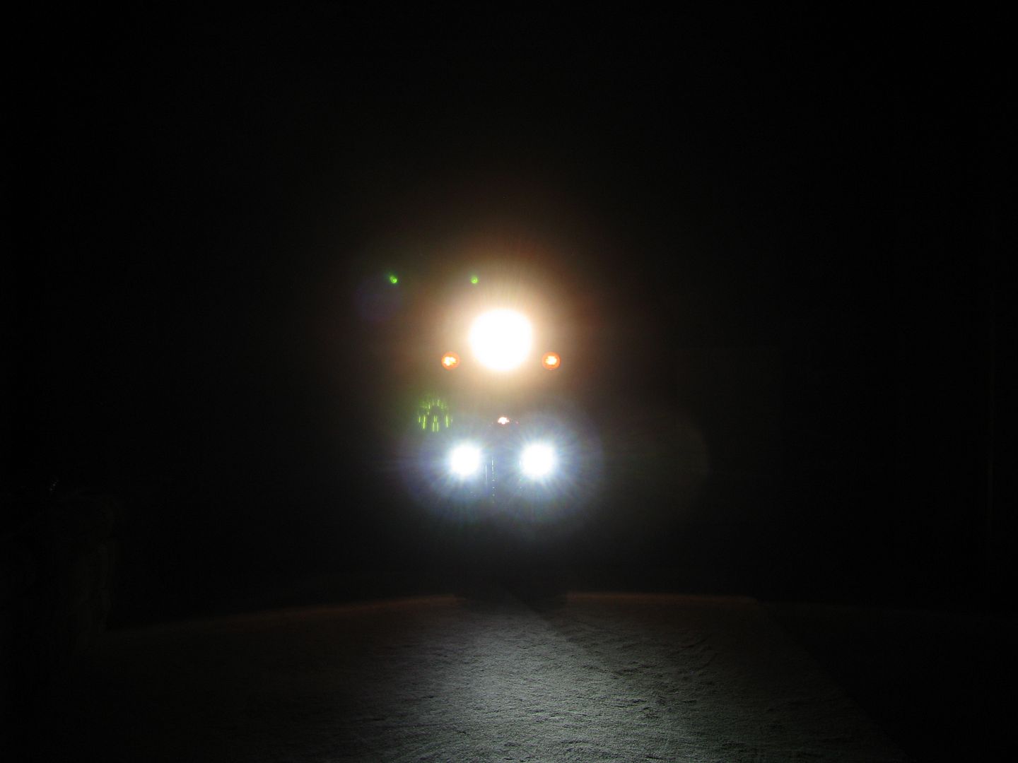

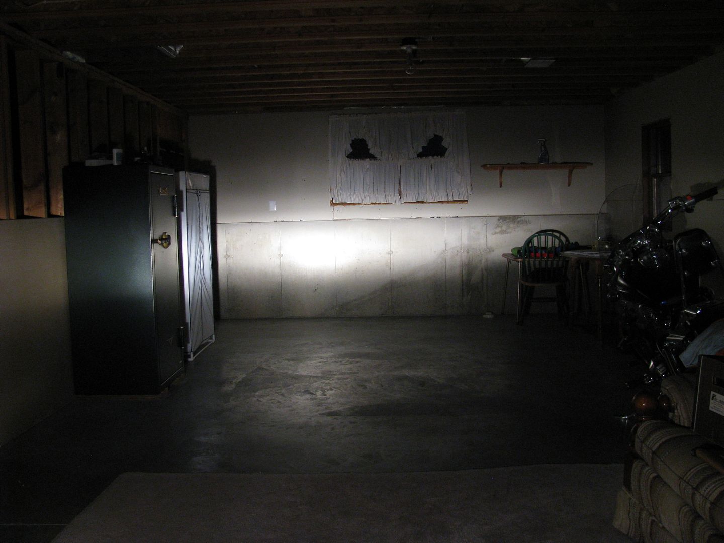

I cant answer that question as I have not done a night road test yet to see if I have them adjusted right. But they cant hurt? I did an un scientific test in my basement.
My CB was parked on the centerstand 27 away from my wall.
LOW BEAM ONLY:
HIGH BEAM ONLY:
10 WATT LED's ONLY:

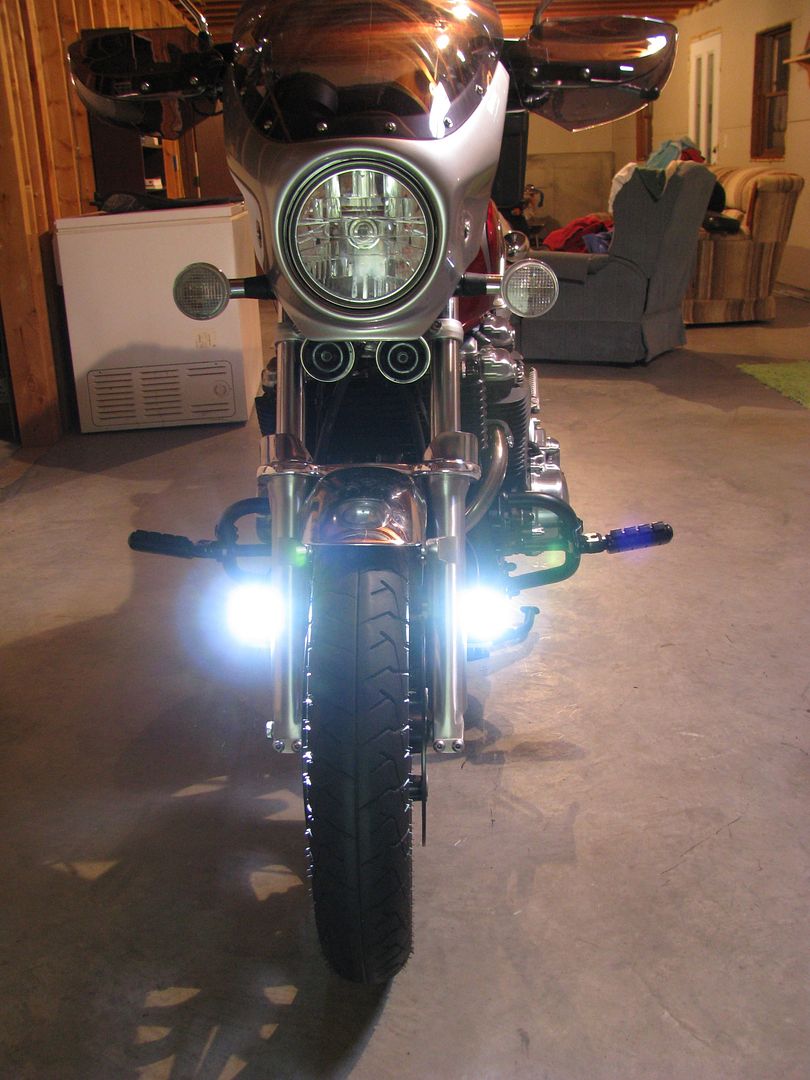

Again, I am certain these will need adjusting as I see fit after a night run. But I am sure people will see me better now:

The mini fairing is a Chic Design with a touring screen. I did think about using spacers but I did not have any the right size in my metal stock pile so I just used what I had. Which was some aluminum stock which I bent by hand.
I think spacers would work but not on the fender bolt. It is tiny and it is screwed into an acorn nut. I have not had much luck with acorn nuts on past bikes. The bolt can bottom out and not be tight if you dont have the correct length.
