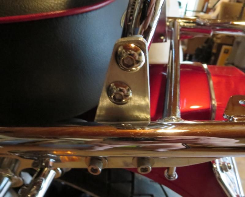

If you purchase a Honda rear carrier and a Jardine sissybar with backrest (regular or mini) you can make some simple mounting plates to attach them together. You'd have to drill a couple holes in each side of the rack, mount the plates and then attach the backrest. There are several threads on this with better pictures and details.
![[Image: ecd54370fe4975a96292fe100eebc259.jpg]](https://cb1100forum.net/forum/uploads/imp/201404/ecd54370fe4975a96292fe100eebc259.jpg)
Other possibilities are the Givi and Hepco rear racks.Both have grab bars that you can mount a back rest.
